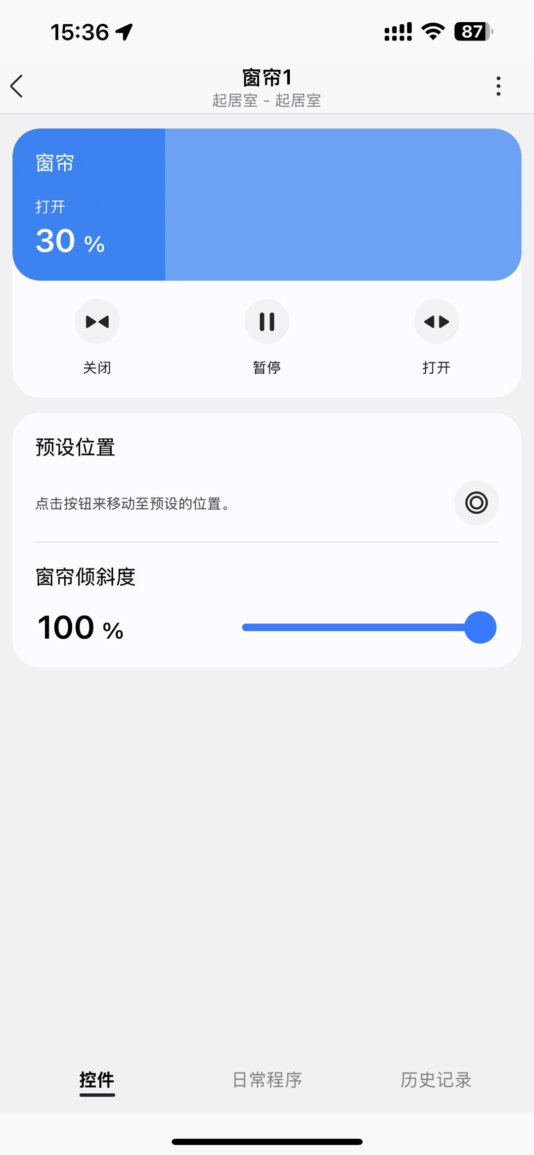

Samsung SmartThings app curtain status is incorrect
I added a Matter curtain motor to SmartThings. This motor supports filt and tilt. When I click the curtain interface to open or close, the filt and tilt status bars in the app are incorrect. The log shows that the last status reported by the device is correct (log as follows). What is causing the incorrect status in the app?
lift report

You can report the issue to SmartThing team directly via Support channel.
So that the team can analyze the issue.
