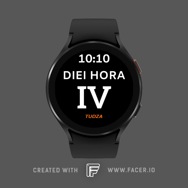

It is not too difficult to port Facer Formulas to WFS . I was thinking we could use Bit Mapped Font but I have not thought it through .
Ah, forgot, WFS has no sunrise and sunset functions. The Roman thing pretty much requires those.

Not sure I can think of a way to use the 0 or 1 reported to do what is needed. I need the time between sunrise and sunset to calculate the length of a Roman hour of daylight.

Listen I am sorry we had guests . I forgot you had the Classic Roman Daylight that had a vsriable length . Yes the FR Meridian was Paris . I personaly think that Greenwich is not to bad as the strange things that happed on the Date Line happen at sea . I think Biel did away with any time Zones .
