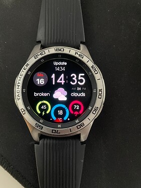

I installed this with my SG-84. See the screenshot. The display does not move in the GWS but on the watch it works.

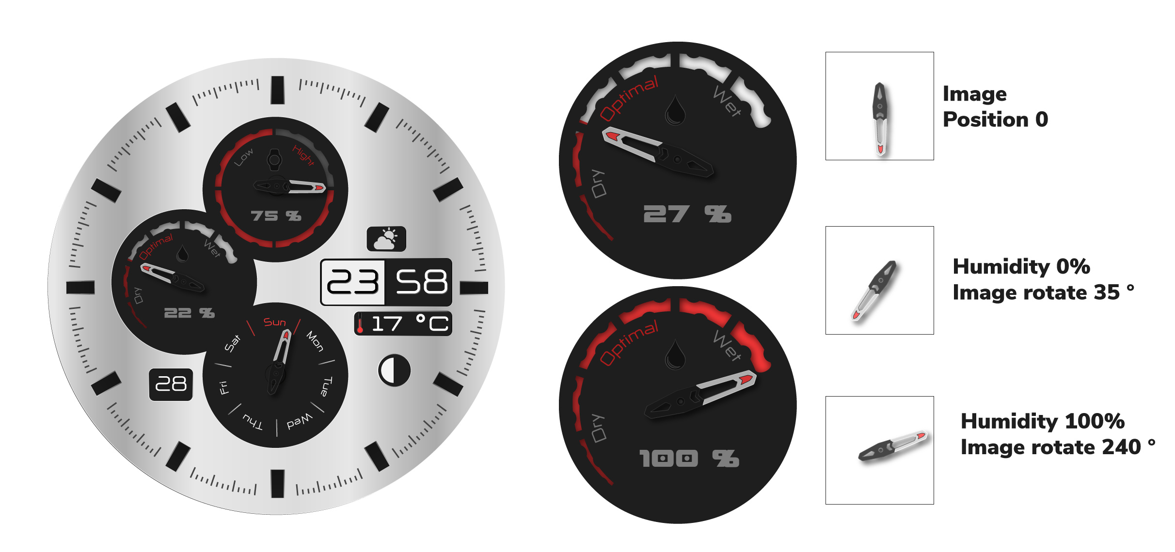

Attached is an image explaining my project as well as an image of GWS.
The weather humidity complication doesn’t work for me, I think we need to create an XML complication … I can’t find the right way to do the XML code for this
complication as for the battery% complication
Thank you very much for taking the time to enlighten me!
MY PROJECT :
GWS :
Thanks !!
I have inserted a watch hand and set at the rotation properties Weather humidity. I have set the starting point and the end point under Rotate. I have tried a long time … I did not edit XML … all in the GWD. All settings are watching in the screenshot. I did not use tags
YES !
Thank you, thanks to you I succeeded!
I will detail the process for those who would ask the same question as me and take the opportunity to ask you to enlighten me on the points that still seem unclear to me.
  1. After the image is positioned we consider it at point 0, the watch hand in my image was positioned towards the south, I had to rotate it by 35 ° so that it indicates point 0 of my counter
  2. I didn’t use the “pivot angle” and don’t know its use yet, if anyone knows ^^
  3. Rotate: It is because I had put 1 that nothing worked for me, it was absolutely necessary to indicate 0 in this field although I still do not understand why …?
  4. I had to rotate my image by 222 ° in total so that the watch hand points to 100%
    (As I rotated my image by 35 ° at the start, my gauge therefore uses a perimeter of 187 °)
  5. The humidity is measured from 0 to 100, if I synchronize the days of the week the end value will be 7
As you said galaxy watch studio updates the text when you modify the values ​​in the administration panel but the watch hand synchronizes on the value it finds when launching the software but not in real time, that is is quite restrictive to have to do the tests on the watch but hey … It works! :wink:
Thank you, I hope you will explain the usefulness of fields 2 and 3 to me, it still escapes me and it will be clear to everyone, thank you very much for your help … finally for your help;)
