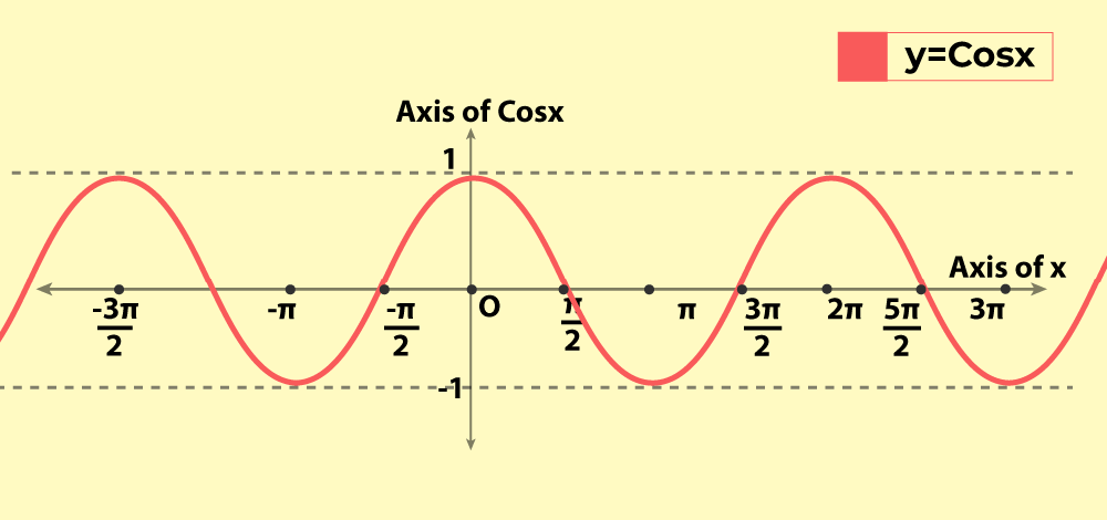

Hey peter! How to Create an Image with 0% Opacity for 5 Seconds and 100% Opacity for the Next 5 Seconds in fade in - Fade out style?
Hi, for example like this:
the higher the number in place of 3 in front of the cosine, the shorter the fading transition.
How did you find this out? This is a crazy formula that I don’t even begin to understand, but I tested it in a watch face of mine and it works
I went to school for many years and paid attention. Just kidding. :grinning_face:
But for sure one has to have heard of periodic functions and how they work, as well as read the documentation on how to use tag expressions in WFS
