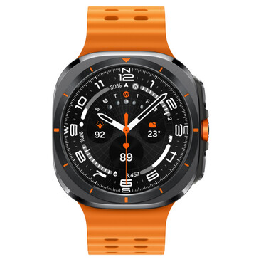

My watch is the Galaxy Watch 7, and there is a watchface for the 7 Ultra that has an active compass on the screen, that’s what I want to reproduce on my watch face in Watch Face Studio

. This watchface has a compass ring, that’s what I want to reproduce in my own creation
Ah, I don’t want to copy this watchface, I just want to make the compass work on another one of mine, I have other face projects ready in Watch Face Studio, I just need to make the compass work
If someone did it because it is possible for wear OS 5, but I want to find out how it was done, if it was in the watch face studio or in the android studio, if anyone has a simple example project that works on the watch please send it to me so I can understand how it is done

@froberfuzi . Ask the Maker of the Face . Probable an expert coder in Android studio . CODE only Composition . No GUI .
The Ultra watch face wasn’t created in WFS, it was coded in Android Studio. It does things we can’t. I want to learn how to do this in Android Studio, but it seems pretty daunting.
Modern watch faces that run on Wear OS 5 must all use WFF (XML). WFF can do some things that WFS can’t, but not many. If this watch face is significantly different, it may be using a deprecated API. WFF and WFS are much more limited than earlier APIs.

That would be ironic, since its only available on the Ultra. The other thing it can do that no other face can do is show Blood Oxygen directly in a complication without having to tap on it.
