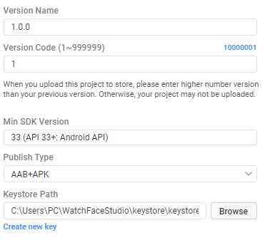

Thanks for the replies. What to do about the Wear OS API 34 requirement though.
WFS 1.8.10 only shows ‘33 (API 33+: Android API)’ on the ‘Publish’ screen. The Memory plugin also only states: ‘Current project requires Min SDK Version: 33 (Android API 33+)’.

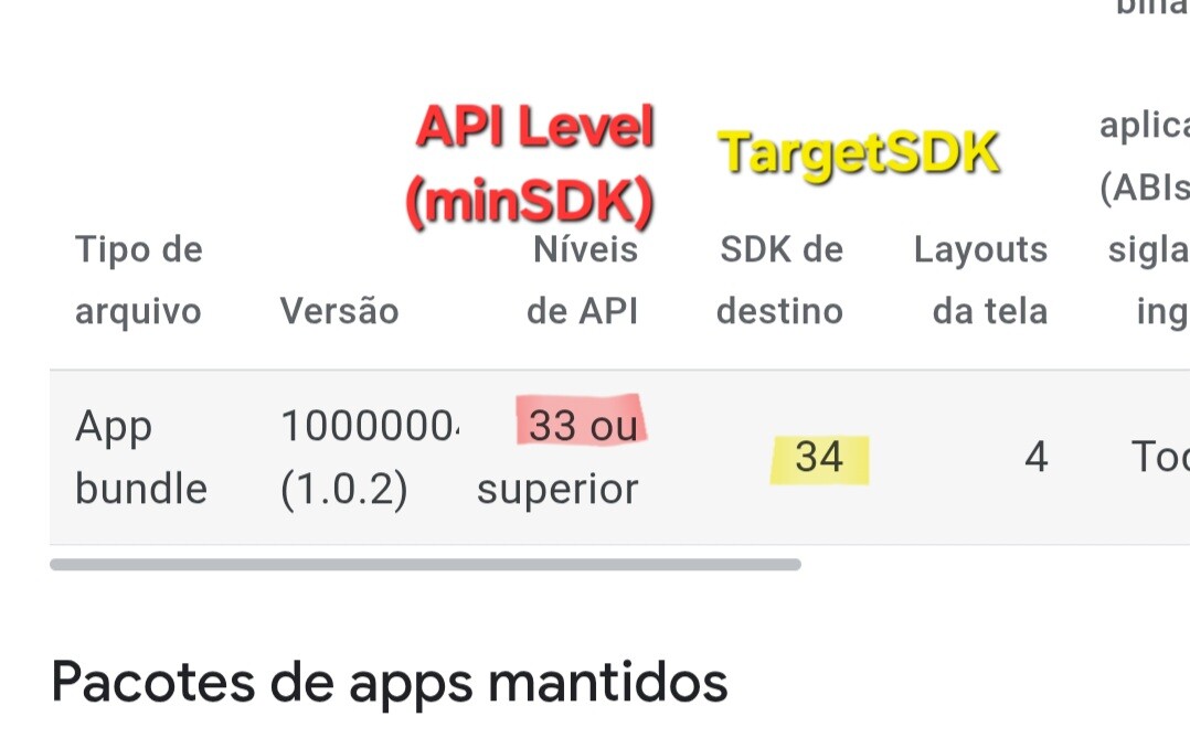

WFS 1.8.10 offers a minSDK of 33, but it builds the watch face with targetSDK for 34 (under the hood). In simple words, WFS 1.8.10 makes your watch face design focused on Wear OS 5, but it still keeps it compatible with Wear OS 4 (or greater).
As long as you rebuild your watch face using WFS 1.8.10 it will be under google’s requirements.
Ps.: When you upload the watch face (rebuilt using WFS 1.8.10, minSDK 33) to play console you can check the targetSDK is set to 34… my screenshot is in Portuguese, in red → min sdk (the same shown on WFS); in yellow → the targetSDK (the value requested by google). This screenshot is from today of a watch face I updated using WFS 1.8.10…
