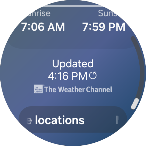

Out of curiosity, you said to update the weather manually, are you talking about going to the weather app and click the update button or something else??
Yes, open the built in weather app, and scroll to the bottom, you’ll see this…tap the refresh icon, and it will update.
