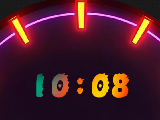

It is a number that is actively changing : like Time font styles or complication font style
I am not completly understanding . You want to change the Font ?
