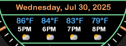

I am trying to update the weather condition for the next 4 hours but the icons don’t appear to be changing. I am using the formulas (forecastHours(1, “COND”)), (forecastHours(2, “COND”)), (forecastHours(3, “COND”)), (forecastHours(4, “COND”)). Any suggestions would be appreciated.

Is it the problem that started after updating the watch to new Wear OS 6.0?
In other words: did the watchface work fine and the problem started a day-two ago or it’s a new watchface and it doesn’t work from the beggining?
Weather is behaving (on my watchfaces) oddly after updating to OS 6.0
  • if the problem started after updating the watch: I think it’s some kind of bug and you cannot do anything about it at he moment
  • if it doesn’t work from the begging check this guide, maybe you skipped something
