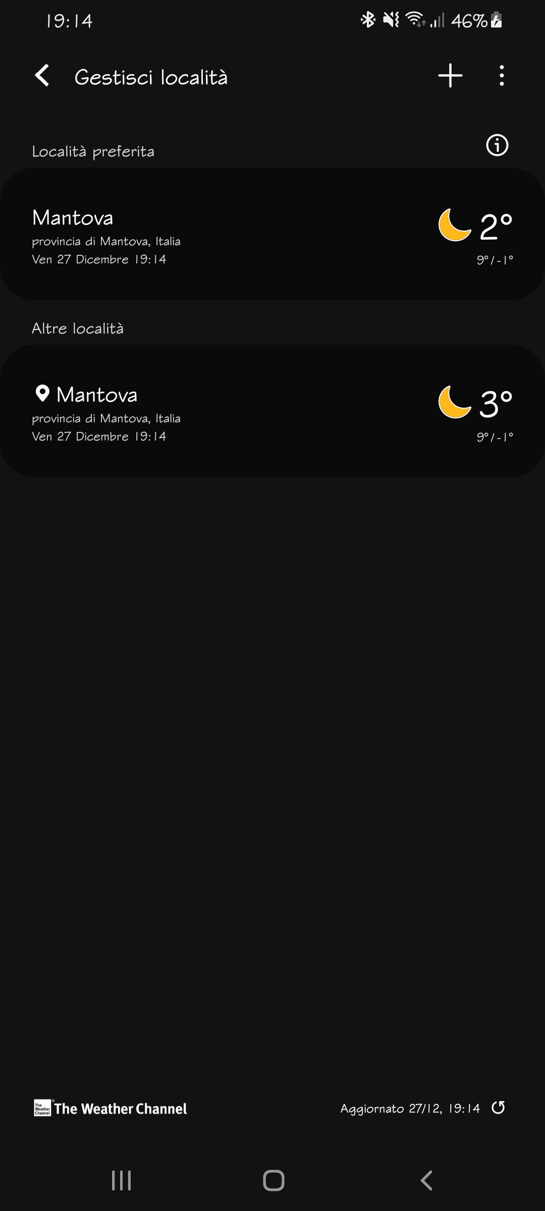

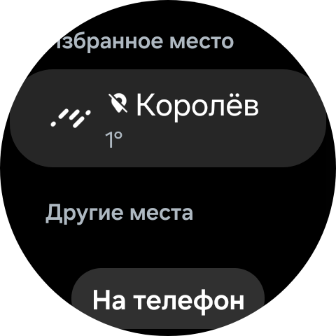

Yes I know, and what you did is fine. Mine could have been an explanation of what is happening and that does not directly concern the watchFace that we make. However I attach a photo where on my watch weather there are two options to set the fixed location or manage it with GPS. If I select the one with the GPS symbol sometimes I lose the signal and it puts null in my WF.

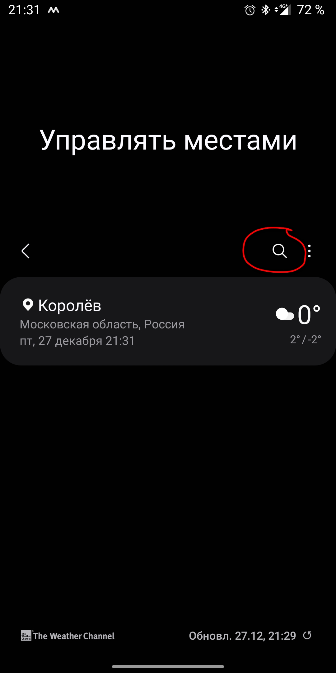

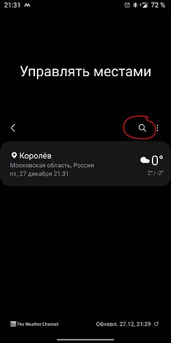

As you can see in the images, there is no option to add a default location in the smartphone or watch. Only the location received via Gps.
Many are in my settings just select the + in the top right and then search for the location. Have you tried selecting the search law?
I know about this option , but I don’t have a “+” to add. When I click on search either nothing happens or sometimes an error appears. Yes the watch is with the latest 6 firmware, after the update I did a full reset of the watch and reconnected it. (Last time 1 hour ago). But alas.

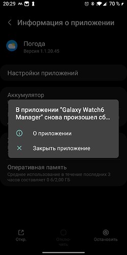

Hello, I have a Galaxy Watch 6 (latest, new firmware) OnePlus phone android 13. I also tried different options to solve the problem, and those options that are indicated above. The result is negative! The weather does not update automatically! Therefore, I think that the android version is not important here.
