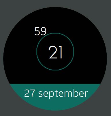

Hi, I want the minutes (59 in picture) rotating around the green circle like a minute-hand does.
How can I achieve what I’m trying to do?
Thanks

Here is how you can do it prepare images from 1-60.Add digital clock ICU format mm, in bitmap fonts, go to custom "add text string 01 add the image for 1 that is your first clock.
Now do the same for the 02 in another clock and image . Please remember you will have 60 digital clocks with the appropriate image corresponding to the minute, place them and rotate them as you please.
Another way would be through tag expressions, put in text images from 1-60 and tag the opacity as
100*([m]==1) for 1 minute and so on, it should work. then place and rotate

I used the second option and it works great. Thanks! :grin:

Hi @Malcolm_319, I have tried the Method of 60 pictures and placing them with Tag Expressions to make my Digital numbers rotate as Minutes,. my file size for all 60 pictures are very Small and in PNG format, but when I load to my watch, it freezes, and the watch face keeps restarting over and over, what am I doing wrong, you mention “Text Images” is that different to uploading 60 Image Files

Try this,
Make and index that has all the minutes then create a second hand is the entire watch face but has a hole in it that masks all else out. Have it rotates minutes in hour, and movement effect is jump by minute and it reveals only the minute number.

Hello, you can try to place 60 text fields instead images around the clock and make them appear on right time using tag expression for opacity. All that will be transfered to watch is the font file and text descriptions.
The hand that Ron mentioned is also simple solution, but may limit the digits size.
Hi @Peter and @r.liechty_SDR , thank you so much for the suggestions, appreciate it. I will try and revert back with the result on both option.
Just to clarify on Peter’s suggestion, I will only have the Text font displaying from the GWS program, as it will be text format, and not a picture, for example, i wont be able to have a circle with the font inside, only the font itself. hope this makes sense?
I wanted to say, if you prepared one image with 60 numbers on it, to be covered with another “hand image” with a hole, that reveals exactly just one of the numbers, those numbers would have to be relatively small to fit into the dial without overlaping.
If you use text fields, they can overlap around the dial, but on the preview/watch there will always be only one of them active, so it will look like orbiting, no matter the size.

Hi Guys. thank you so much for the suggestions, I got the watch face working with 60 Images set to ([m]==1)*100 etc. it works perfectly
