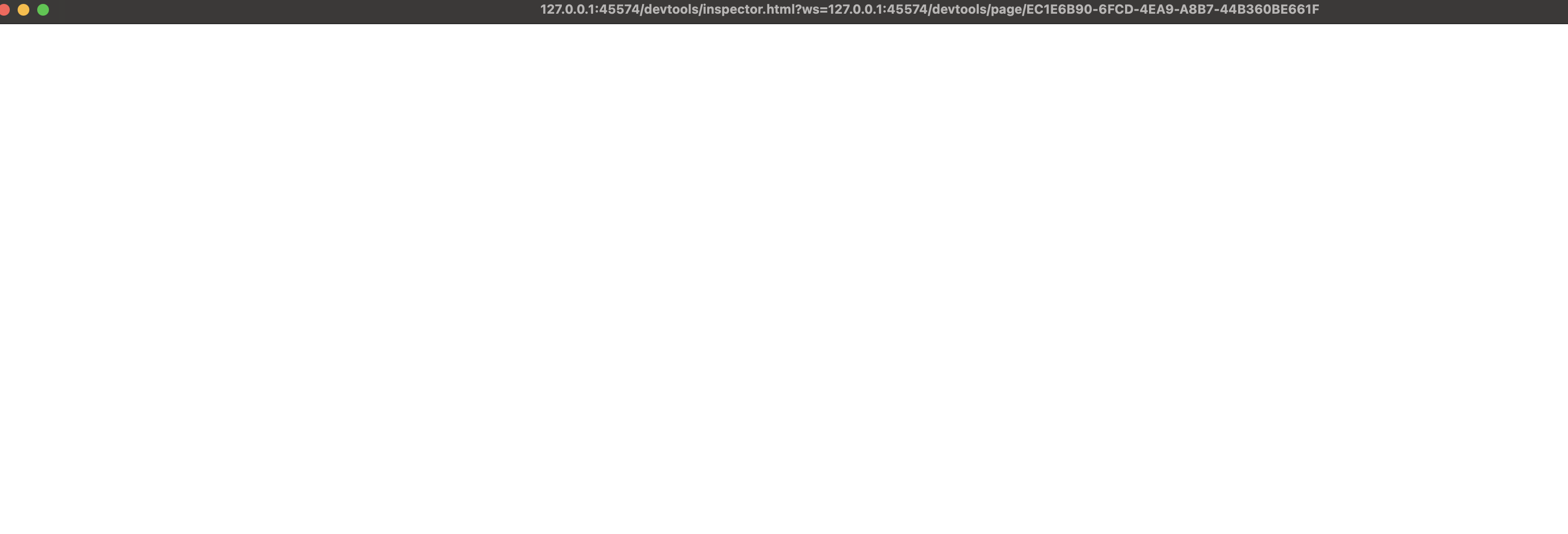

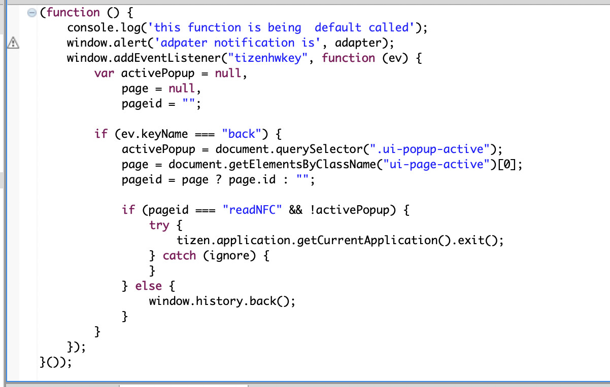

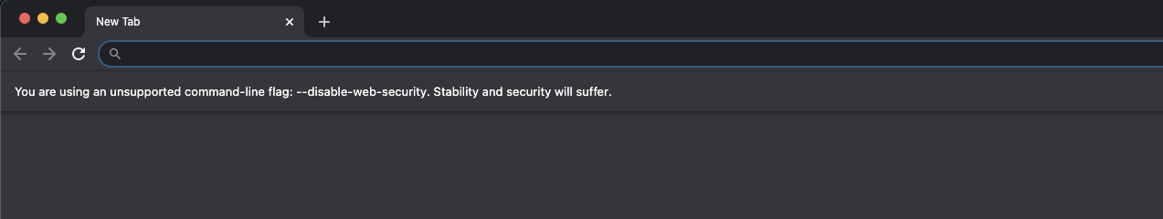

I have tried couple of ways to see the console log in my web based smart watch app but could not find the way to see the logs.
When I run the application as Debug mode, all I can see is blank chrome inspector screen with no way to see the logs.
1 : Run in debug mode
2 : Blank chrmoe Inspector screen
3 : No log in console log view in Tizen studio while running in debug mode
4 : Sample JS file containing log statement

Are you facing this issue with real device or emulator?
shyam
July 6, 2021, 6:33am
3
Hi, Issue is with real device. I can see logs in emulator.

Hello,
Would you please try to update software of your watch?
It was a problem on older version of firmware. If you face this problem again after updating your software version, please share the software version with us.
