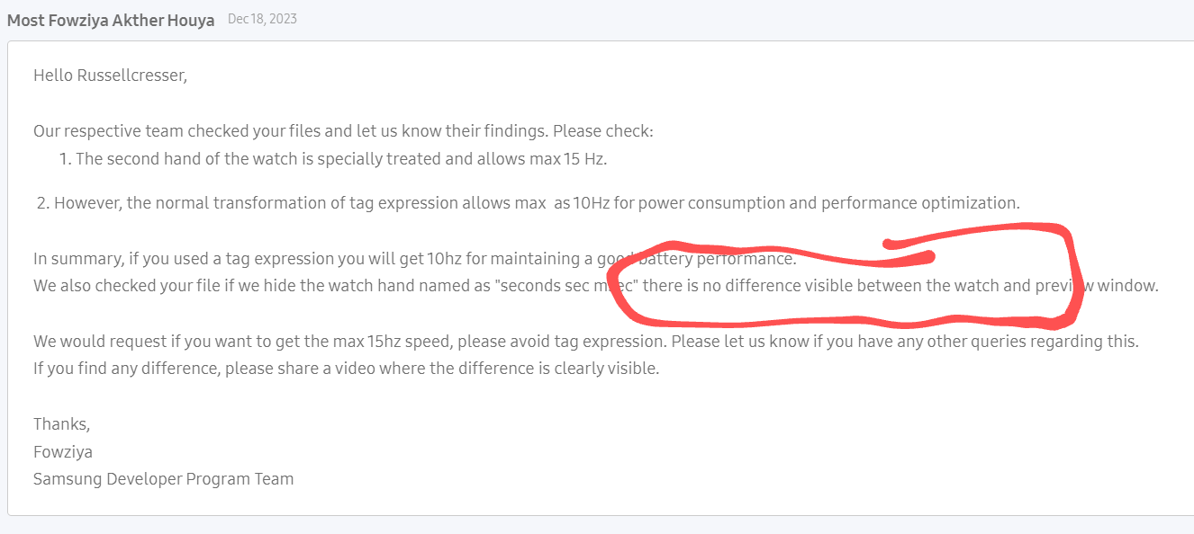

I got this the other day actually but it does not really answer the Question and does not work either .
Its around there 10hz which is = 100ms refresh rate. So they saying they not going to speed up the tag expression refresh rate.
If it was 1/10 sec it would not look glitchy with the 10HZ hand sweep . So it is not even that .
Do you mean using the 10hz sweep without tag expression already glitchy? Meaning the hand sweep is also having issue?
No I think the 10HZ hand sweep is good as far as I can tell . This formula on an Image of the same hand superimposed should be the same according to Samsung .
((floor(([SEC_MSEC])*10)/10)*6)
But it is exactly the same ( Glitchy ) as other tests I have made . Ron and Samsung Consider the Question Solved . So noting is going to happen from this point on .

If they Hide the Hand that shows the error there will be no Error ! So I think I Know that . I can not use the smooth ( 15HZ ) action of the seconds hand to animate any thing else on the WFS platform . Either they are a bit Thick or assume I am .
