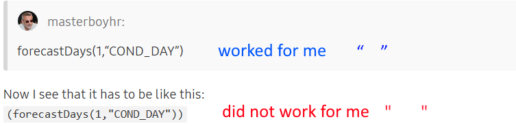

take this into consideration when it doesn’t work:

Yes I think you always have to do that to show numbers in a Text Field . I always use plenty of ( ) I know it is very amateurish but if it works it works .
(forecastDays(1,"COND_DAY"))
I meant the upper quotation mark
OK I see . I am lucky when I type “” I only get “” .
Strangely enough, other quotation marks work in some codes. :melting_face:
Sometimes if you copy and paste stuff that is not Format Protected it gets corrupted . I store all my Formulas on Notepad or Notepad++ .
