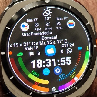

Hi, in case you want to put more data on the watchface, I have adopted the method of making four different data sections appear for 15 seconds. Precisely to not have too many things on the watchface that could generate confusion in reading them. I attach a file for you to try.
com.fabio102.rivoltella.only.ULTRA V12.apk.zip (1020.7 KB)

The apk I attached is to be tested on the watch, installing it via the app on the phone BugJagger. Otherwise if you want I send you the link of my WatchFace with the relative APK files to download and the info including the demonstration videos.
I have installed the apk. It gives me a black face without any information
Hi what watch do you have?
In addition to the file I attached you can see my watchfaces here
I do have a Samsung watch 7, and I do not see any faces on that link.
