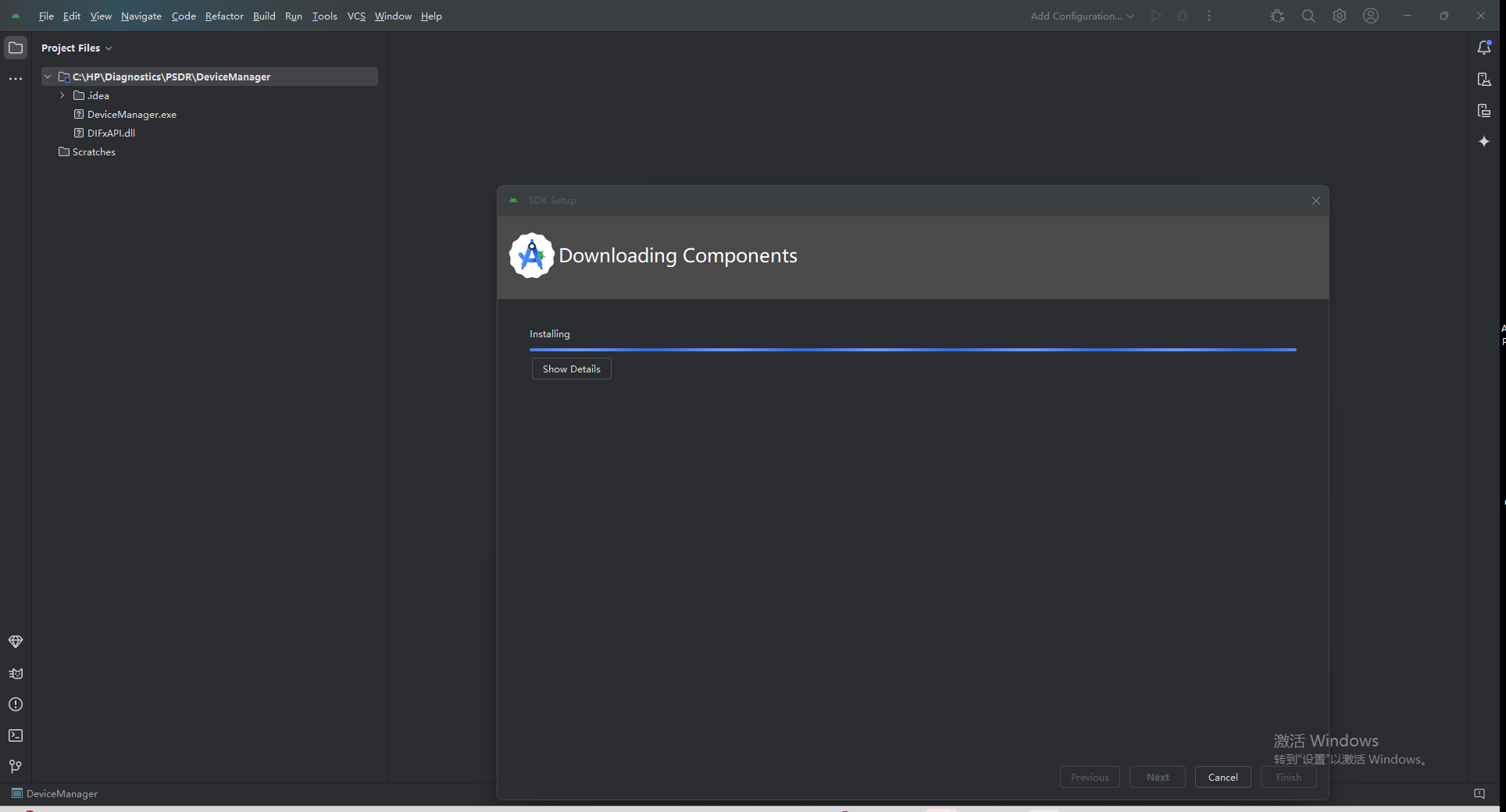

I’m stuck again. Keep downloading. Cannot continue.
I can not help you there . I have never used AS to Sync a Face from WFS .
