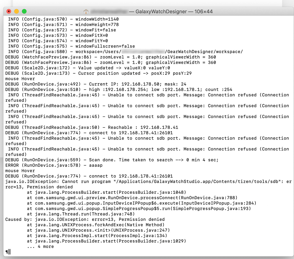

I then tried to start GWS through the finder. Here I received the following log:
Error: ApplicationInstanceManager.java:78 - Busy Port?!
Error: Unable to connect sdb port?!
A reference computer with Windows 10 and Galaxy Watch Studio works perfectly.

GWS uses Port 26101 check to see if there is some other app that uses it. I recall a few releases ago there was a lot of problems with a streaming service that also used that port.
One of our technicians used a tool from Tizen Studio to connect to connect and after that the GWS worked. The tool sdb.exe is also included in Galaxy Watch Studio 2.0 but it didn’t work. The Tizen Studio version worked after 3 tries and the RSA encryption key popped up and no problems after that with GWS.
contact Samsung Developer Support to get the tool and instructions on how to fix it.

Thanks Ron for your answer.
With the Tizen Studio and Device Manager I got a connection without any problems and the RSA query on the watch came immediately. Afterwards the clock was immediately available in the GWS.
Thanks again.
