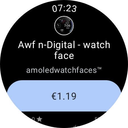

It seems that the situation has moved a little better, but the watch face is not displayed in the mobile app. It can be found in the watch play store, but when you try to pay and download the watch face, it throws an error - your device is not compatible.
SCR2-watch-compatible

I just tried to throw in a test package. It still gets instantly wear os type “ACTIVE” with the small change that all devices are instantly “supported”. Unfortunately, the problem was not solved at all as watch face cannot be downloaded/found through phone and download through watch is giving “incompatible device” error. :frowning:

I think if this app was free, the download would work. The problem is that when the app is paid, and you click “buy” in the watch play store, you have to complete the purchase on your mobile. So you go to your mobile, click notification to continue purchase and a message with “application is not compatible” pop up, and the whole purchase is canceled.
