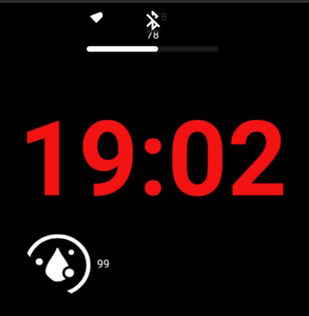

Not Getting what I design
This is what I want.
This is what I get on the watch.
What am I doing wrong??
TicWatch Pro 5 Wear OS 3.5

I have a 466x466 round watch.
Why would i test on a rectangle?
Oh sorry but the image you have shared is rectangular shaped. The 2nd image. I thought it was a rectangular watch.
The complication layout is automatically selected as per the complication provider. That’s why you are facing this problem.
Please check this thread: Complication text font size too small when Run On Device - #7 by r.liechty_SDR, hope it will help you.

What baffles be is that the bar size was severely reduced and changed for HR and nonexistent for the BO2.
I have seen both seperatly as large bars so i know it can be done.
If you have any sample project which you can share please share, I will try with my watch.
Hi, what complication type u using? Circle? Line? Or?
U may have 2 issues here…one is the one Boshra (scaling ?)mentioned
The other is the auto layout selection…to force to want u want is to do as explain in my topic
He is using Line specifically Large Box Complication as per his 1st image, if I am not wrong.
Hi, seem the watch selected a layout that for first complication (text, progess bar)
2nd complication (icon/image and text)
So he need to force it to select to (icon, progress bar only)
Or modified each and every layout. Then try again. See if it help .
My guide explains it all as best and clear as possible.
Yes, large box with progress bar.
