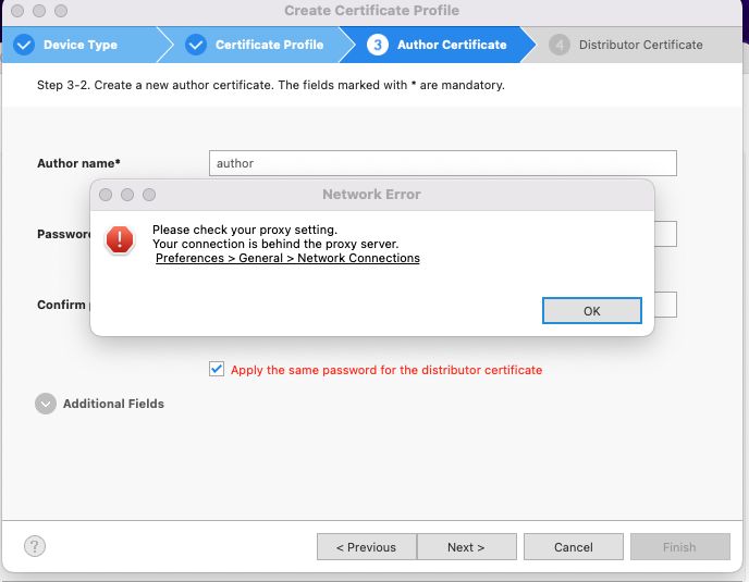

When trying to create a new Certificate for Tizen, after entering the Author name and password and signing ind with samsung, I see this error:
Please check your proxy setting.
Your connection is behind the proxy server.
Preferences > General > Network
→ Which Version of Tizen Studio you are using:
6.1
→ Device information for which you are creating the certificate (Watch/Tv).
TV (Samsung 2020)
→ Your operating system information
MAC OS
→ Are you creating a new author certificate or updating the existing one?
Creating a new author certificate please
→ are you trying to create tizen or samsung certificate?
Creating Samsung Certificate
→ If possible could you please share the video?
Image attached below, thanks:

I’m having the same issue during “Distributor Certificate” setup. It seems to be some connection issue with Samsung server (ip: 112.106.187.16 port:443). Rejecting connection during TCP handshake. See Wireshark:
samsung_cert_tcp_handshake_fail

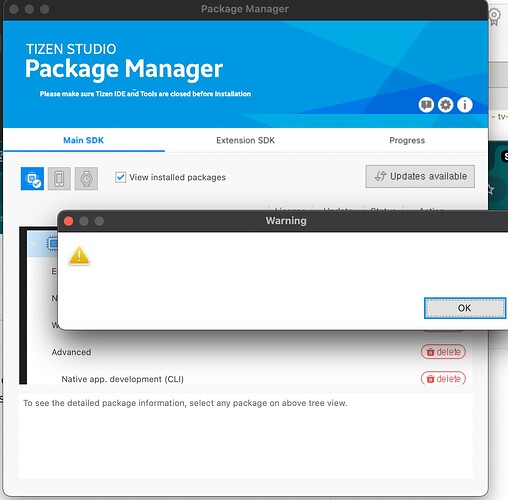

Hello,
The proxy error issue has been fixed. You have to install updates from Package Manager to resolve the issue.
Go to Tizen Studio < Tools < Package Manager, then click on “Updates available”
After updating successfully, check the issue again. It should be solved. But if the problem persists, please let us know.

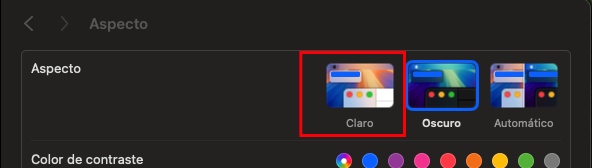

You need to change Macos system aspect to
You will see that the warning is that you need to close all tools and TizenStudio first to be able to update the Samsung certicate extension
