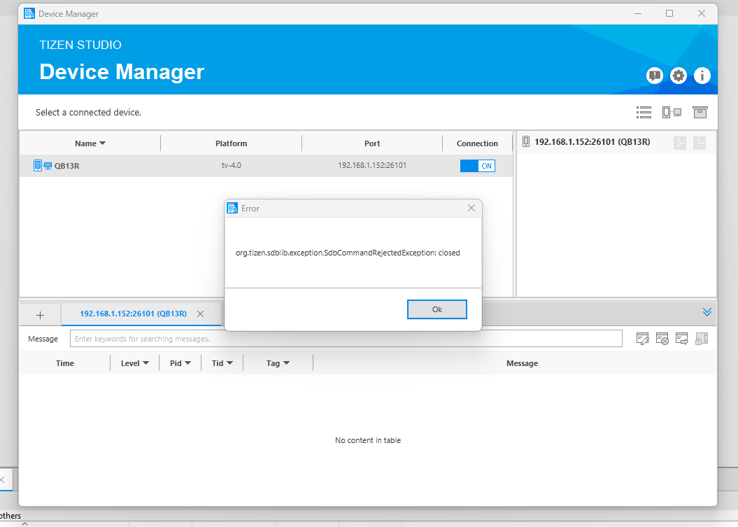

Thank you for answer. My application works when I run it using “Run as” from Tizen Studio. However, on my TV, I get an “installation file not found” error when I try to install it.
Is there any way to run this application on the TV right now, or is this error related to the current certificate issues? Am I making a mistake somewhere else?
